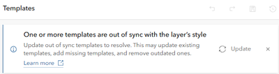

Update: In Spring 2025 we added support for managing templates in Map Viewer in ArcGIS Online. You'll see this in Enterprise 11.5 as well.
You can find the Templates button in the Configure editing menu.
We also added a new feature in both Map Viewer and Field Maps to alert you when the symbology and templates are out of sync. You can click the Update button to automatically sync them. Don't hesitate here- you can always Undo the changes if you need to.
Check out this blog article for more info.
