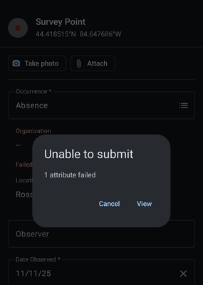

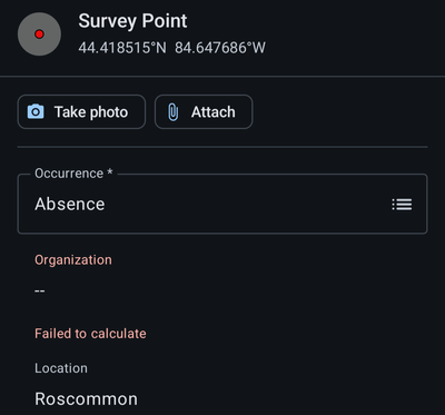

I have a field that is not required, but calculated and automatically set to read-only. The field is supposed to select an organization based on the logged in user. If the user doesn't have an associated organization, it should be null - however, the field just has a line through it and it is preventing data from being submitted even though the field isn't required?
It throws a "Failed to calculate" message and when I hit submit the message is "Unable to Submit - 1 attribute failed"

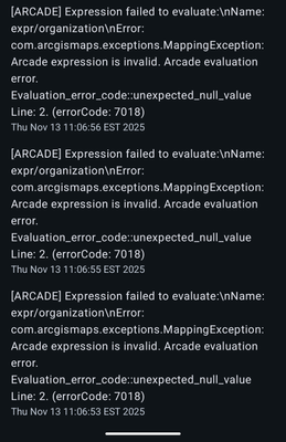

Logs:
It seems to work just fine in the web map and in experience builder and it doesn't throw any issues when I run it in the arcade builder

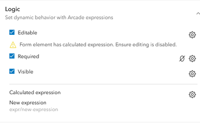

I see! This is exactly what happened to us as well, do you have these all enabled?
It should look like this here:
And this in the map:
Does this match your current setup?
Cody
luckachi
I do not

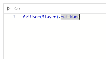

As @CodyPatterson said this will work more reliably:
GetUser($layer).fullName
However, only the username will be available offline. I would generally recommend against using fullName if there is any possibility that the maps will need to go offline as the calculation will fail and the edit will need to be discarded.
GetUser($layer).username
