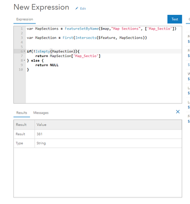

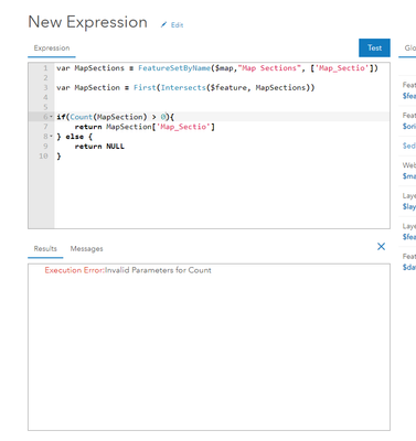

DamonBreen
  • I do see some minor issues with your code (case is wrong on the first return) and I would try not using Null at first just to make sure (I think it is Null BTW).
I did not try to alter this one, as I have a few other codes that return a Null with success, I think Null is OK.
  • Also I am not sure IsEmpty will work right so use Count.  I would also test doing a return of Count() to make sure intersects is finding something.
I have attached two screenshots below showing the difference when swapping between Count and IsEmpty. Count seems to error out, while IsEmpty returns the correct map section.

Ahh opps I forgot you have first in there.  Need to do count before that.
I would start with
var MapSections = FeatureSetByName($map,"Map Sections", ["Map_Sectio"])
var MapSection = Intersects($feature,MapSections)
return Count(MapSection)
and see what you get.  I have a feeling it is not finding anything.
