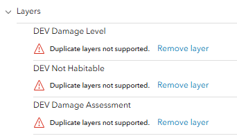

It is not possible to have duplicates of a layer in a webmap. I tried that, where I had the assessment layer (Flood / Storm) not visible by default, and duplicate copies symbolised as Damage Level and Not Habitable properties.
"Duplicate layers not supported. Remove layer" is the message I got.
