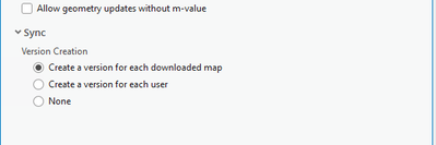

I am just testing my luck here to see if anyone has encountered this offline map downloading issue in ArcGIS Field maps in the past.
We have a feature service with a single feature class configured with traditional versioning and on the feature service configuration it is setup for offline map use. We have noticed that when the feature service is set to 'Create a version for each user', the offline map download will fail. The offline map would be downloaded if it is set to 'Create version for each download map'. I understand that setting the feature service with 'create a version for each download map', is a more common configuration and it is something we can definitely entertain as a workaround, but it would be nice to understand why setting it to 'create a version for each user' would cause the offline map to download to fail.
Thanks
SH013
As it turns out that this is a known bug issue. If you have versioned data and your service is set to create versions based on user names, downloads will fail if the username exceeds a certain length.
BUG-000157028 - Replica versions created through feature services using the Create Replica operation in ArcGIS REST APIs have a limit of 30 characters, not the 64 characters documented for the version's geodatabase system table.

that I am not sure, but we are already having issues with downloading the first map area.
