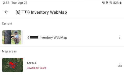

Hello everyone,
I am just wondering if anyone else has been having this issue. I can set up an offline area in the Field Maps online web application, then when I try to download that offline area on Field Maps Mobile (tested on two android devices) I receive the "Offline Areas Failed to Download" Error and the log tells me that feature tiling is disabled. Now this is frustrating. However, when I create on offline area in the Field Maps Mobile App, the map is created an downloads just fine.
I assume this is an ESRI bug but I want to air it out on the forum first to see if anyone else is replicating this issue elsewhere.
