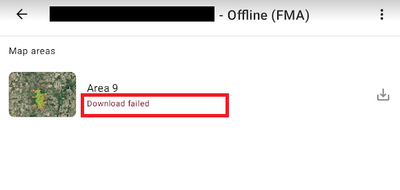

Hello everyone,
I am just wondering if anyone else has been having this issue. I can set up an offline area in the Field Maps online web application, then when I try to download that offline area on Field Maps Mobile (tested on two android devices) I receive the "Offline Areas Failed to Download" Error and the log tells me that feature tiling is disabled. Now this is frustrating. However, when I create on offline area in the Field Maps Mobile App, the map is created an downloads just fine.
I assume this is an ESRI bug but I want to air it out on the forum first to see if anyone else is replicating this issue elsewhere.

Certain layers when shared from ArcGIS Pro as Web Layers will prevent Offline Areas from downloading. It is a pain but export any layers you want as hosted feature services in the map to shapefiles, zip them, then import these zipped shapefiles into your ArcGIS Online folder, choosing the add and create feature service option. I underwent fairly extensive testing with an ESRI analyst on this, and while they weren't sure what the issue was, this workaround did work, and I was able to take maps offline that I previously wasn't able to. Note when when maps failed and this workaround helped, I was just getting a generic "Download failed" error message in Field Maps. Hope this helps some of you.
