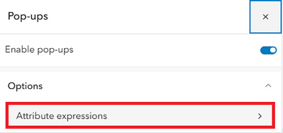

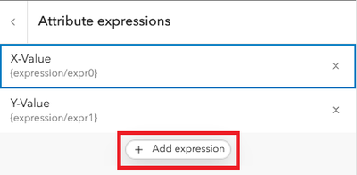

Try adding these fields in the "Pop-up" attribute expressions for desired feature layer.
X-Value
return Round(Geometry($feature).X, 2)
Y- Value
return Round(Geometry($feature).Y, 2)

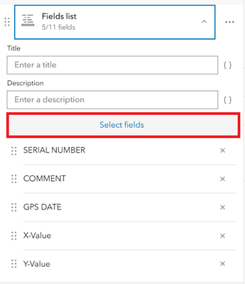

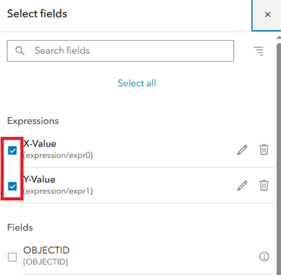

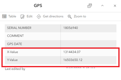

fjramos
I forgot a couple steps:
The in the Pop-up "Field List" add the created expressions on "Select field"
Check the X, Y expressions
And they should be on your pop-up now
