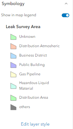

I have a polygon layer with two overlapping grids, each with different inspection intervals - Distribution (36 months) and business districts (12 months). How can I ensure that my meter inspections check if they are located within a business district and pull the correct inspection interval? Currently, the inspections are only pulling the green polygon with a 36-month interval.

Hello,
One way is to Filter your feature set by your render field before doing the intersect.
var point = Geometry($feature);
var inspectionType = 'Business District';
var polygon_layer = Filter(
                      FeatureSetByName(
                        $map, 'Leak Survey Area', ['*'], true
                      'unique_renderer_field_name_here = @inspectionType'
var polygons = Intersects(polygon_layer, point);
if (Count(polygons) > 0) {
  for (var f in polygon_layer){
    return f.interval
  else {
    return 36;
return (Count(polygons) > 0)
