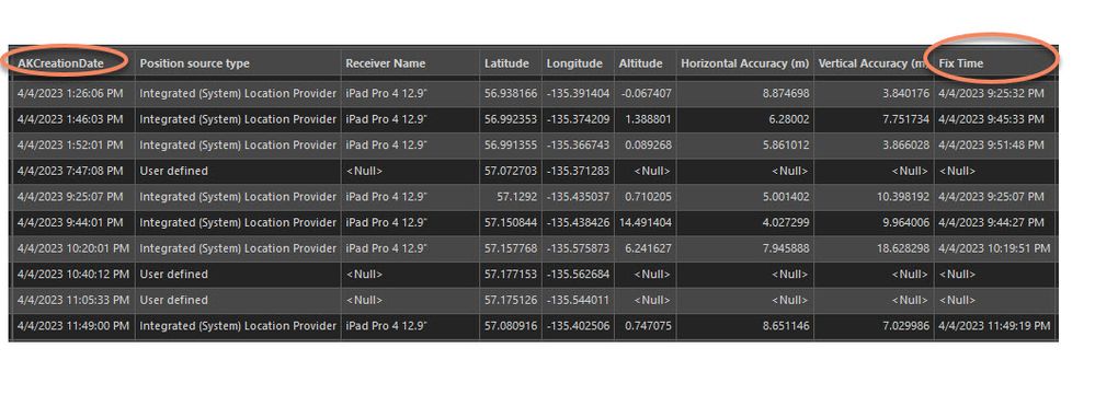

The screenshot below shows the arcade expression and resulting datetime in Alaska or that was my goal. You can see the location Fix Time in UTC. The first few records in AKCreationDate look good, but we have a boat using Starlink so they are basically connected. Then the other records match the fix time and those were collected offline and those values were not converted to local datetime which leads me to believe ToLocal does not work offline.
var dt_now_utc = Timestamp()
var akdt = ToLocal(dt_now_utc)
if (IsEmpty($feature.AKCreationDate)){
    return akdt;
}else{
    return akdt;

The table screenshot above was from ArcGIS Pro so the first few values in the AKCreationDate wrote with the 8 hour offset from UTC datetime which was perfect. I found that out on AGOL/web maps with the data displaying with local browser and its just easier on my part for processing data and dashboards to also have an AKCreationDate field.
