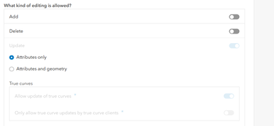

@VenkataKondepati  where is the query option? Please see my screenshot below:
VenkataKondepati
Query option is enabled by default, and you don't need to do anything if you only want Query.
