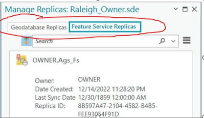

Just saw the new version of Pro will have it.
For now I am using a python script to make a report.  As long as Pro is logged in it will grab the credentials from there.  it gives the username and last date, etc.
