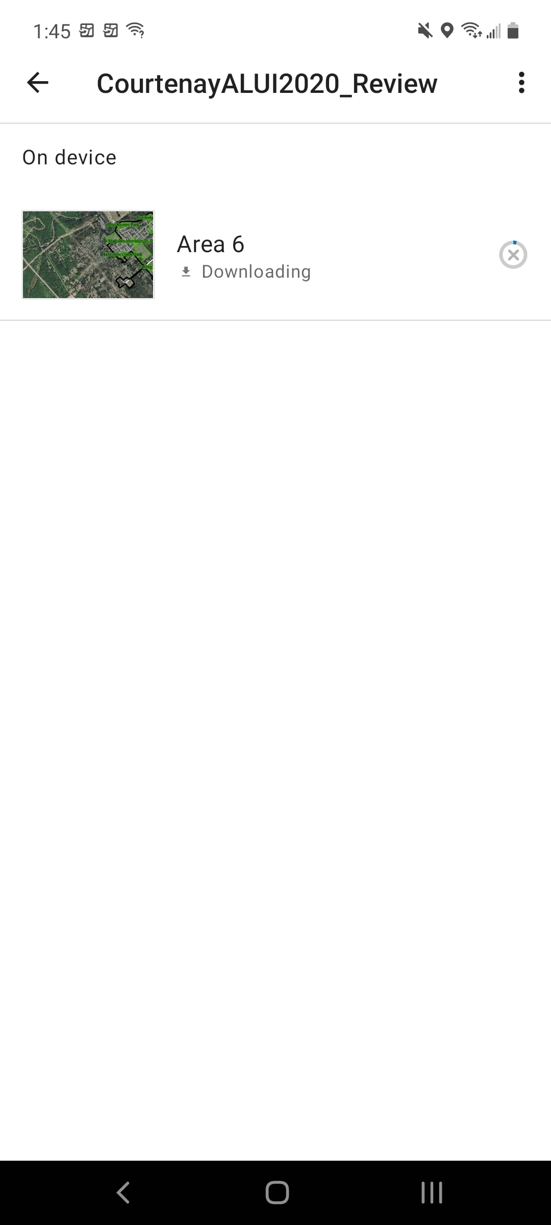

Issue: when attempting to download an offline area in Field Maps, the error "An error occurred downloading the map area" appeared, and the offline area could not be downloaded. After some testing, it appears that this error is being caused by the existence of a 'copied' layer within the map. This is evidenced by the fact that the download does not work when the copied layer is present, and works once the copied layer is removed.

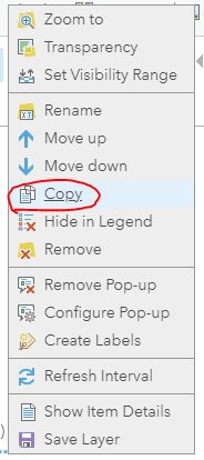

A layer is duplicated:

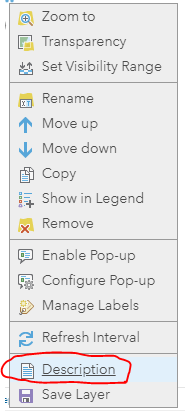

In the copied layer, there is no option 'Show Item Details' where offline settings can be enabled. 'Description' takes the user to the REST Services Directory for the original layer:

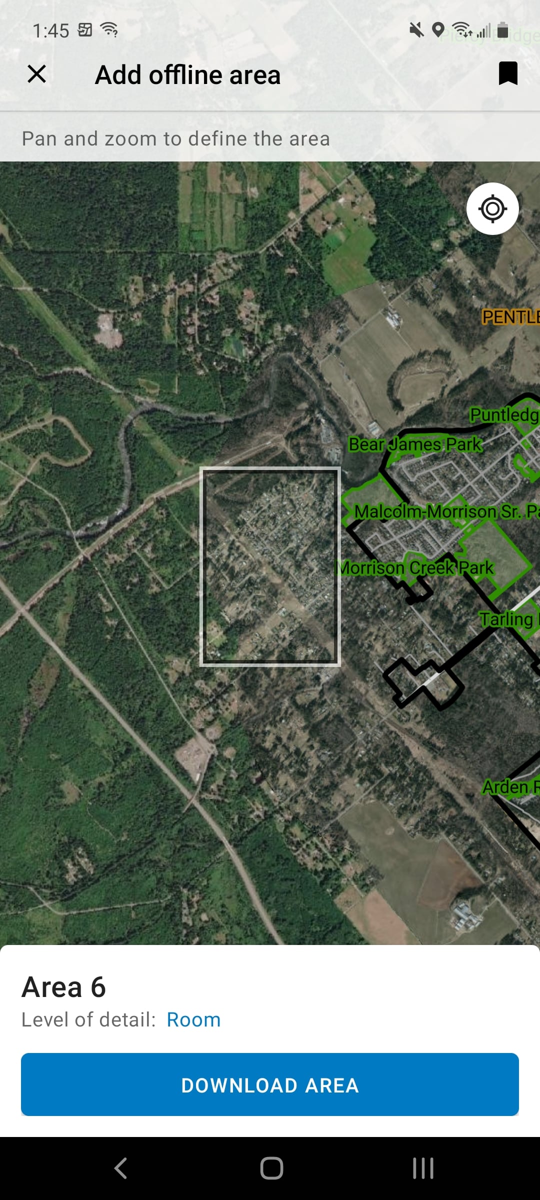

Map refreshed in Field Maps app, and 'Add offline area' selected. Selection screen appears:

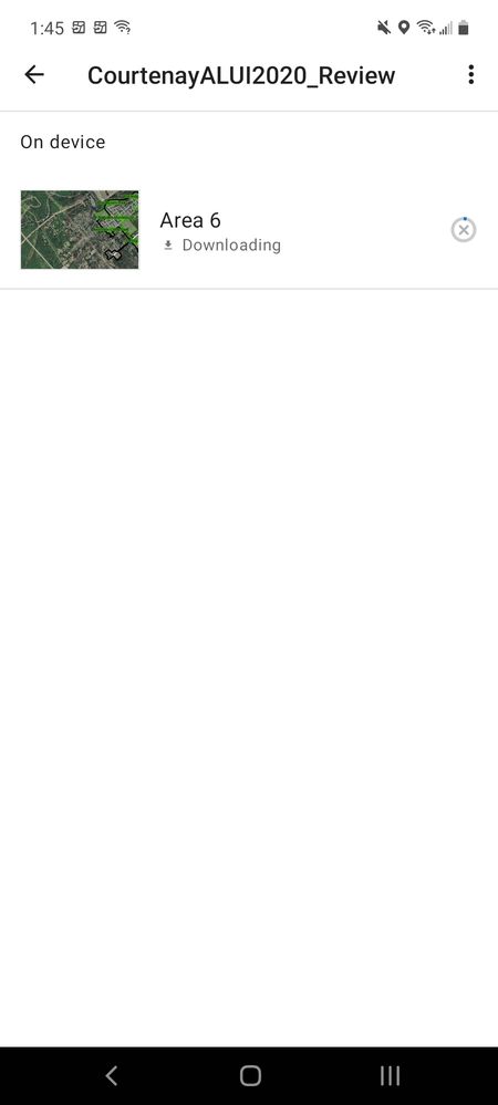

Area is selected for download. Download commences:

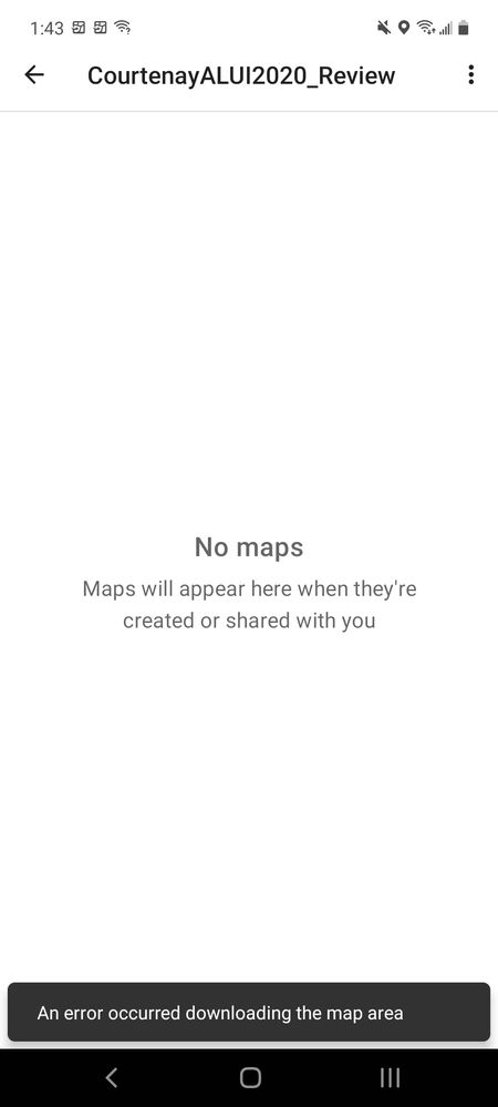

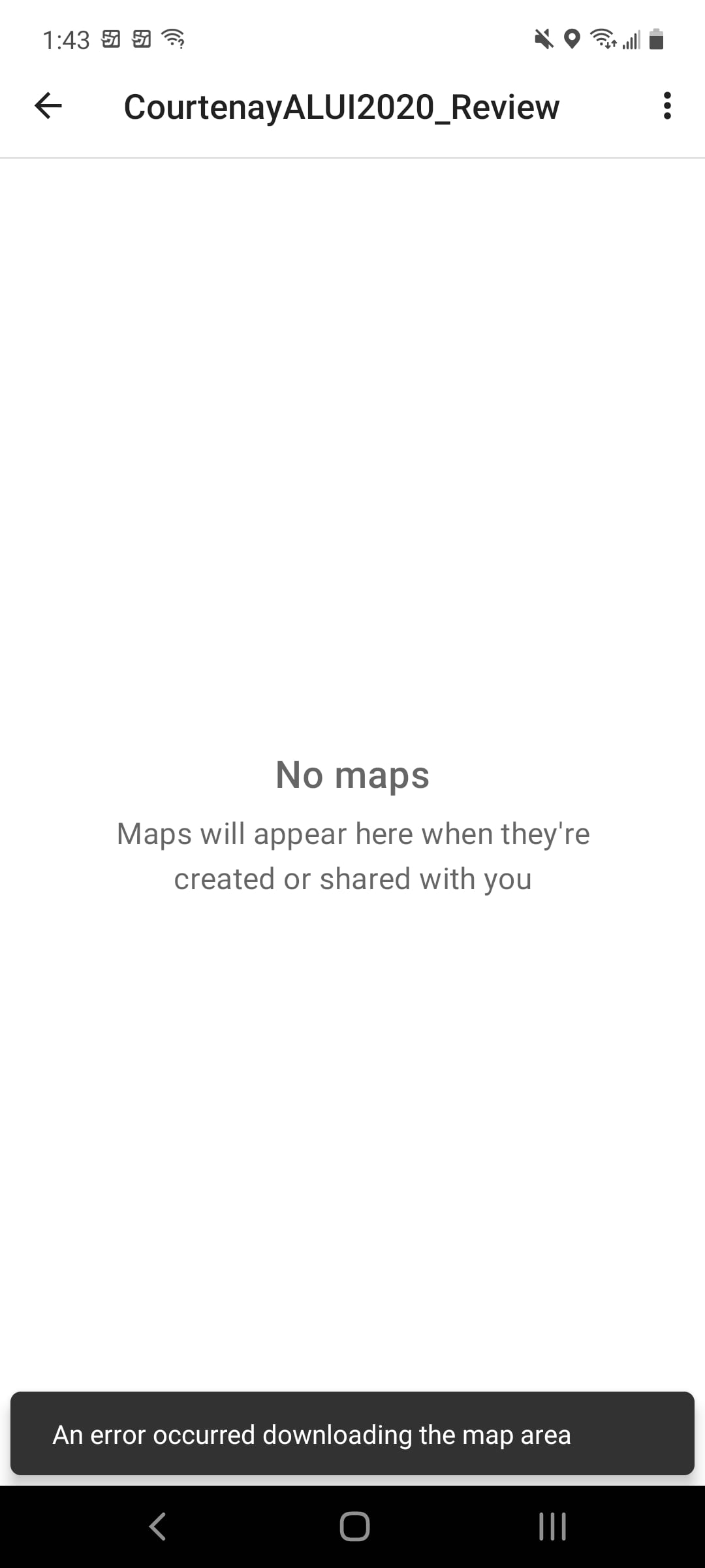

Within 1 - 10 seconds, download is abruptly ended and error message appears at bottom of screen:
When the copied layer is removed from the map, the download is completed as expected.
