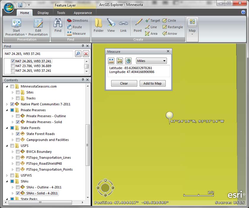

In ArcGIS Explorer Build 1700 the display of coordinate information in the Measure window is incorrect. The labels Latitude: and Longitude: are mixed up. Note the coordinates in the Find window, the Measure window, the pushpin, and the status line in the screen capture. There is no latitude greater than 90 degrees or less than -90 degrees.

This swap of strings has been corrected for the ArcGIS Explorer 1750 version.
Thanks for bringing it to our attention.
