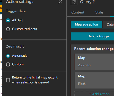

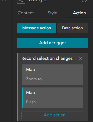

I can easily zoom to a result from a query on a polygon feature. There's no need to use the data action; instead, you should use the message action. When the record selection changes, it will automatically zoom to the selected feature when you select that option.

Have you tried a separate query widget with those configurations for just the polygon layer to see if a configuration issue or something else?
When you click on map, zoom to does the trigger data have all data selected?

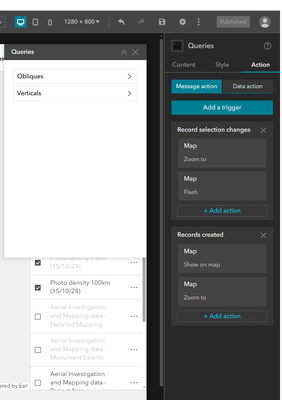

SimonCrutchley
Okay... I tried setting the verticals as a new query and it worked fine. I then added the obliques and hey presto, that didn't. This suggests that the zoom functionality only works for the first element in the query.
I guess I can do a workaround by creating a button with the two queries in it, so it looks seamless to a user, but it seems rather odd and annoying.

I can get it to work with both point and polygons within the same query widget though. Definitely weird behavior.
