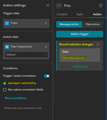

@masslc Maybe this will be helpful - and I am assuming you are in ArcGIS Online or a recent version of Enterprise > you can configure message action based on selected features to select or filter related records.
Here's an example: in this map I have a layer of Tree points, and a related table for inspections. In the Map widget (or any other widget that supports selecting features), I can setup a "Record selection change" message action to select or filter the related records associated to a Tree point I selected.
In my example, this will filter out the inspection records in a Table widget. You could have multiple related layers listed within the same table, or have separate tables for each. There are also other widgets that can display lists for records that you could use to represent the information.

Hello @AlixVezina , thanks for your reply! I have a couple of follow up questions about this while I'm trying it out. First, Are you adding any kind of message or action to the table widget to filter out that data, or is all the filtering happening through the Map actions you have set up?
This is a message action configured at the Map level. You need to configure the message action in the widget where the trigger (e.g. a selection) occurs. So in my example, when I select a feature (tree point) on the map, the action is that it will filter the data in the targeted layer (related inspection record). The message action is only configured in the Map widget and filters the targeted data source (which may be displayed in many widgets along with the Table).
