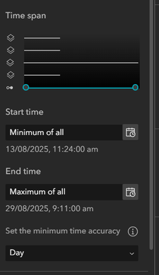

I then find out in Experience builder timeline widget, I can configure the end time to "Maximum of all". But the widget seems not reading all layer's maximum end time properly.

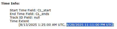

On the layer, the end time goes to

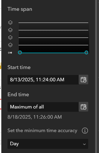

But the widget seems can't find the new feature's end time and update the maximum end time correctly.

In timeline setting, it can only find the maximum time as 29/08/2025

The reason I ask is that your data did get updated to 9/5, but in your service, the extent does not pick up the latest changes:
