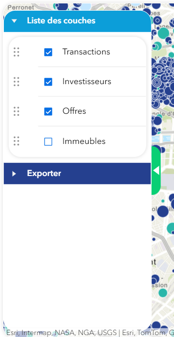

I, here is my simple question : there is a way to click on the sidebar area when the widget is reduced ?
I used the sidebar widget to create an accessible menu on my map like that :
But when i reduce the sidebar, i cannot click on my map because the application "understand" there is the sidebar area here, and it's very annoying.
Anyone can help me ?

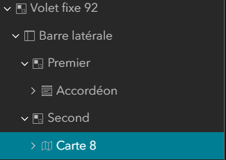

Yes, you will need to place your Map inside the Sidebar as in the link above. An Accordion should work in place of a Column in this recipe, but if not, you can always place the Accordion within a Column.

JasonBOCQUET
Just by following your URL, and do this it works perfectly in the way I want :
Thank you
