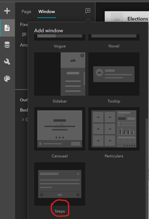

Hello,
is it possible to add the "Steps" Window as a Splash Screen?
I can add other Windows but the Steps type will not allow? It will only sit as Anchored.
I would like to create step by step instructions on a splash screen for a public consultation and the other single windows I feel would end up far too large on screen.
Or is there a way around this?
Thanks

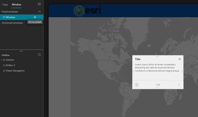

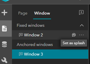

Hi @CMcDonald, it is possible to set a Steps window as a Splash window.
The Steps window is the only kind of window that's added as an Anchored window, and Anchored windows can't be Splash windows.

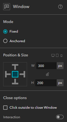

So, you need to switch the steps window to Fixed in its settings panel on the right of the builder.
Once you do that, the Set as splash button appears.

@CMcDonald Also, you can control how large any window appears on screen by dragging the edges to resize the frame, or by entering a specific size in the widget's settings.

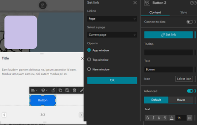

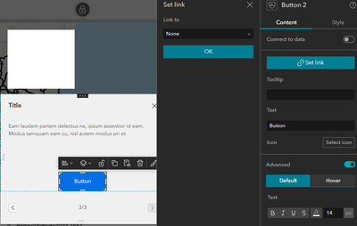

I just need to figure out now how to "OK" the screen in order to close the splash.  I have added a Button in order to dismiss the window but assume I then need to set "Set link" back to URL?  Apologies, going off topic here.
This setting 'seems' to work...

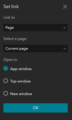

@CMcDonald You are correct with the second screenshot. The best practice is to add a button, set the link to a page, then select Current page. That way, the user goes to whatever page is currently open and nothing has to reload.
