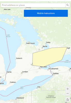

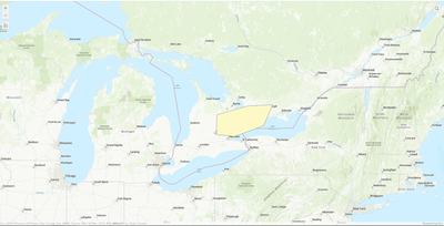

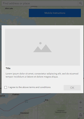

I did some testing on my end and you could have a similar version of this if you add a window that isn’t a splash screen and add a button widget that is titled something like “mobile instructions” that only shows up in the mobile layout and then have the button linked to the window that you created this will make it so that it's only accessible on the mobile layout. the only downside of this is it won't show up right away when the user opens the experienced builder.
Desktop view
mobile view
after selecting button
