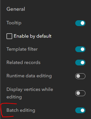

AlixVezina
Batch editing is also now available in the Edit widget when using "Interact with a Map widget" mode, in Experience Builder in ArcGIS Online. Enable the option in the General settings.
