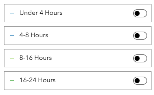

My current work around is to use a Filter widget with filters on each of my data subsets (arcade expressions in my webmap that only display specific time frames)  and download icons from here with my line symbol colours. The only downside I see so far is that the toggle button is backwards. When it's flipped to the "on" position the data disappears from the map.

Sounds like you are well on the way to a great solution. The next steps would be to write your filters backwards (turn IS into IS NOT), link them together with an OR and then use the Apply This Filter Automatically Option. If my logic is correct, this should make turning off a filter turn off a style.JeffreyThompson2_0-1761334747234.png
