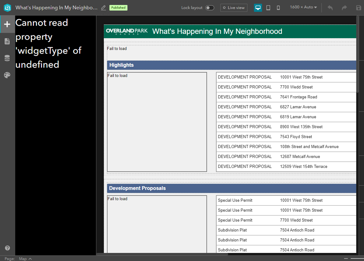

Renaming Widget Error: Cannot read property 'widgetType' of undefined

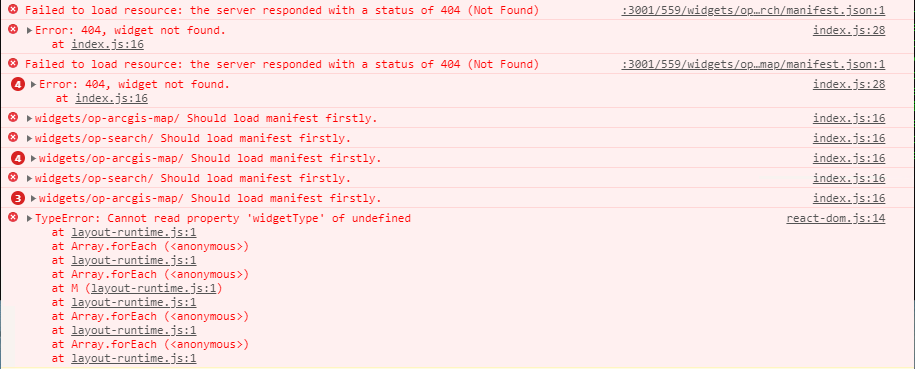

Up to now I have been working with Dev Edition v1.1 and wanted to try migrating to v1.3. When I ran into trouble, I tried migrating to v1.2 where I did not encounter this error:
My project has 2 custom widgets that I developed, but only one of them fails. A third widget that also fails is simply a copy of the argis-map widget that I renamed and made a few changes in mapbase.tsx to disable all navigation (replacing/enhancing the functionality of the disable zoom scrolling option). All 3 custom widgets worked correctly in v1.3 when I tested them in a new ExB project. Again, I have no problems migrating to v1.2.

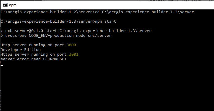

I also see errors in the server command window:
Any thoughts regarding this would be appreciated.

I am running the developer edition on a pc (IIS turned on, of course).  Here are the errors from the console:
What made you think that enabling CORS was the answer?

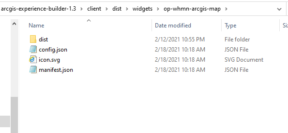

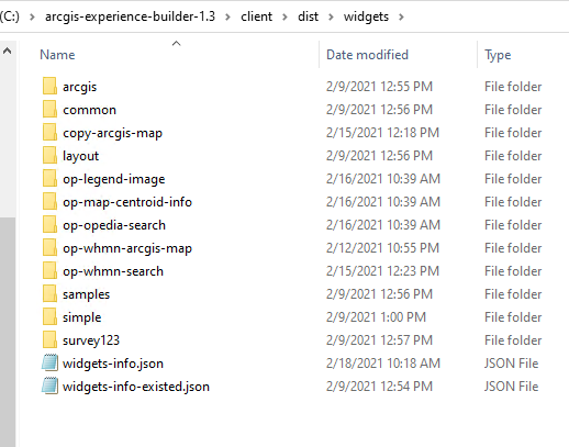

I may ask a basic question but, are the file from the 404 error accessible from file explorer in client/dist/widgets ?
DaveFullerton
This is not a basic question for me, Alexis.  I don't see anything there or within the widget directory:
