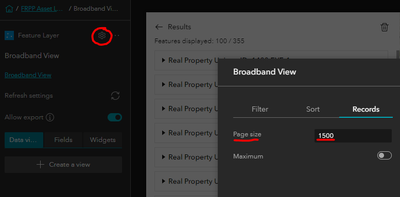

In ArcGIS Online, I am attempting to display more than 100 features from an Experience Builder Query widget in its Results section:
I need all results to show up here (as well as on the map).  I can use the scroll bar on the side, and repeatedly scroll it down to the bottom and eventually, I have all records, but this is not acceptable for the end users:
I have tried to change the Page Size within the Data-Feature Layer Settings - Records tab - Page Size.

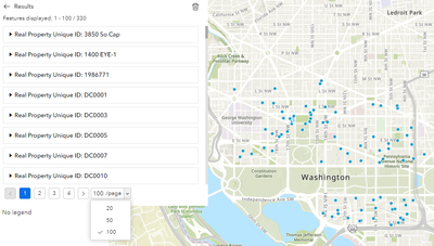

My first inclination as a user is to use the dropdown for the results per page, which caps out at 100. At this point I'd think I'm still stuck with 100 records max:

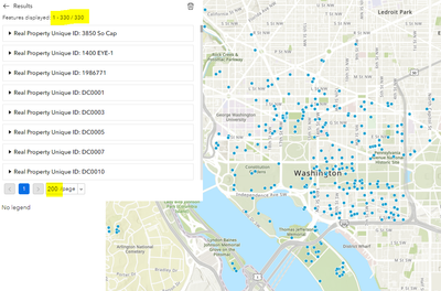

But you can actually click on the number and increase this above 100; here I've set it to 2000 to mimic behavior that lots of users are used to (default 2000 max records returned by the server on many services) but any number larger than 3 digits gets cut off which could add more confusion. It does successfully display all 330 records from my query though:
