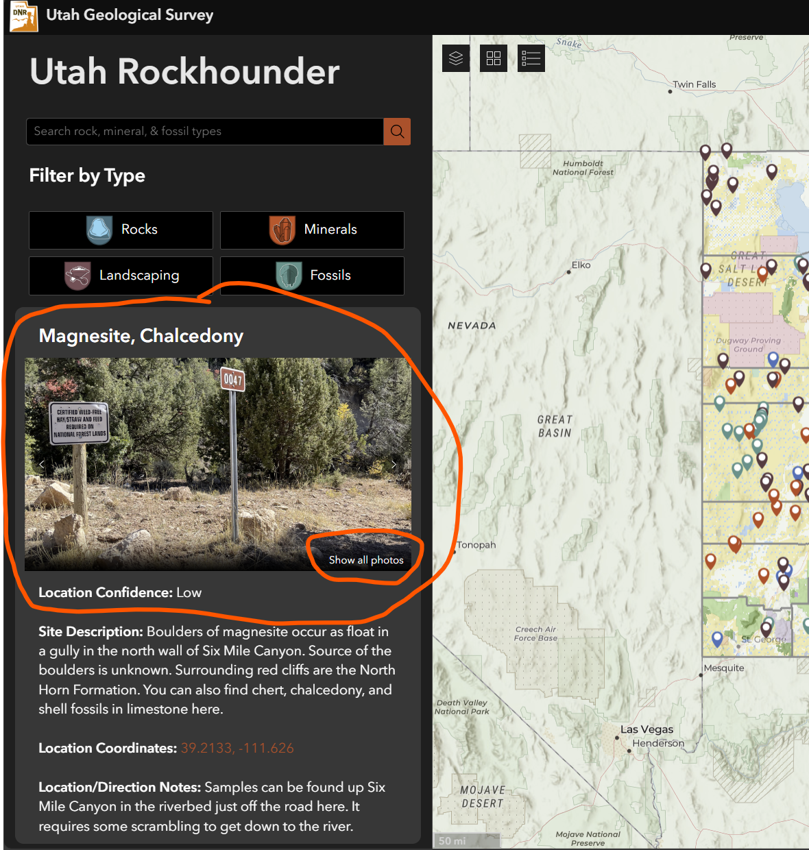

I want to create the type of photo carousel functionality that I saw in this experience (Utah Rockhounder).
The main page has section with what looks like a Card widget. When the user selects any feature on the map the Image widget inside the Card widget shows the photos associated with feature on the map. In my case, these images are in a related records table (this is an inspection app, and every asset inspection is a record in the table). I need to show the images for the most recent inspection. (See image below)

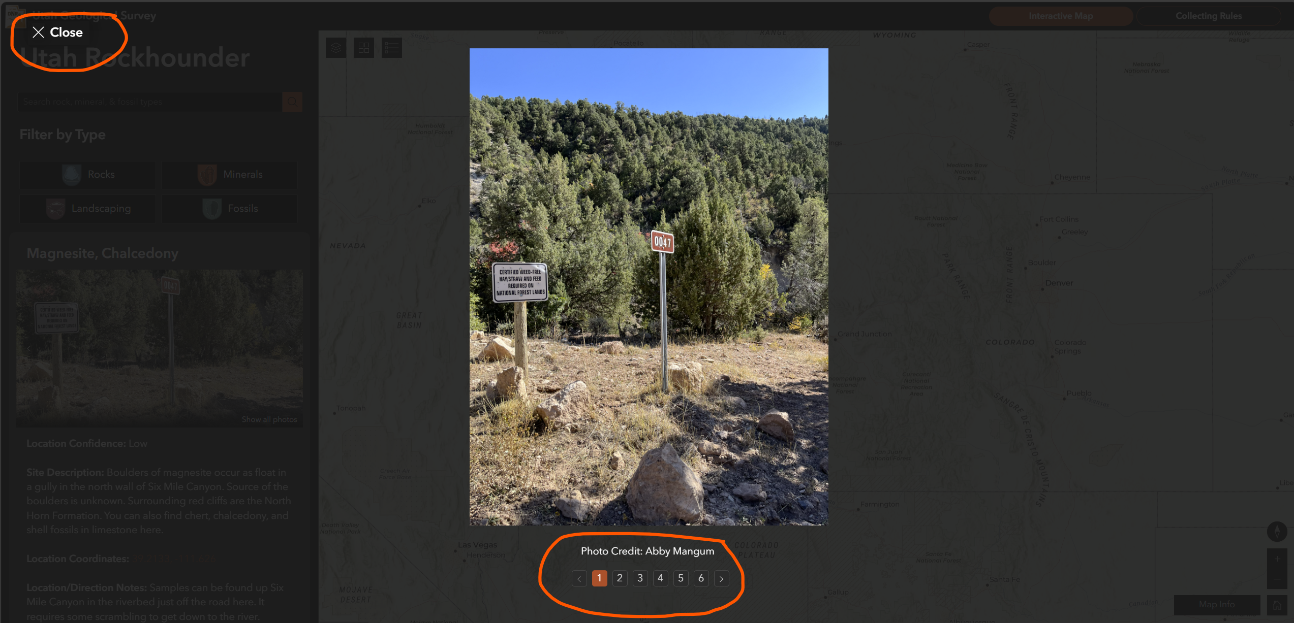

Additionality, you can see that the Utah Rockhounder experience has a button at the bottom right corner of the Image widget that says, "Show all photos". Clicking the button opens a new window with bigger photos in a carousel that shows the number of pictures and selection buttons at the bottom. (See image below)

It looks like they used a List Widget with a Multi-Page Paging Style and One Item Per Page.
If you'd like to make an automatic carousel look at the Section Widget, but you will need to set up each View in the Section individually, so it may not be practical if you have a large number of pictures.
