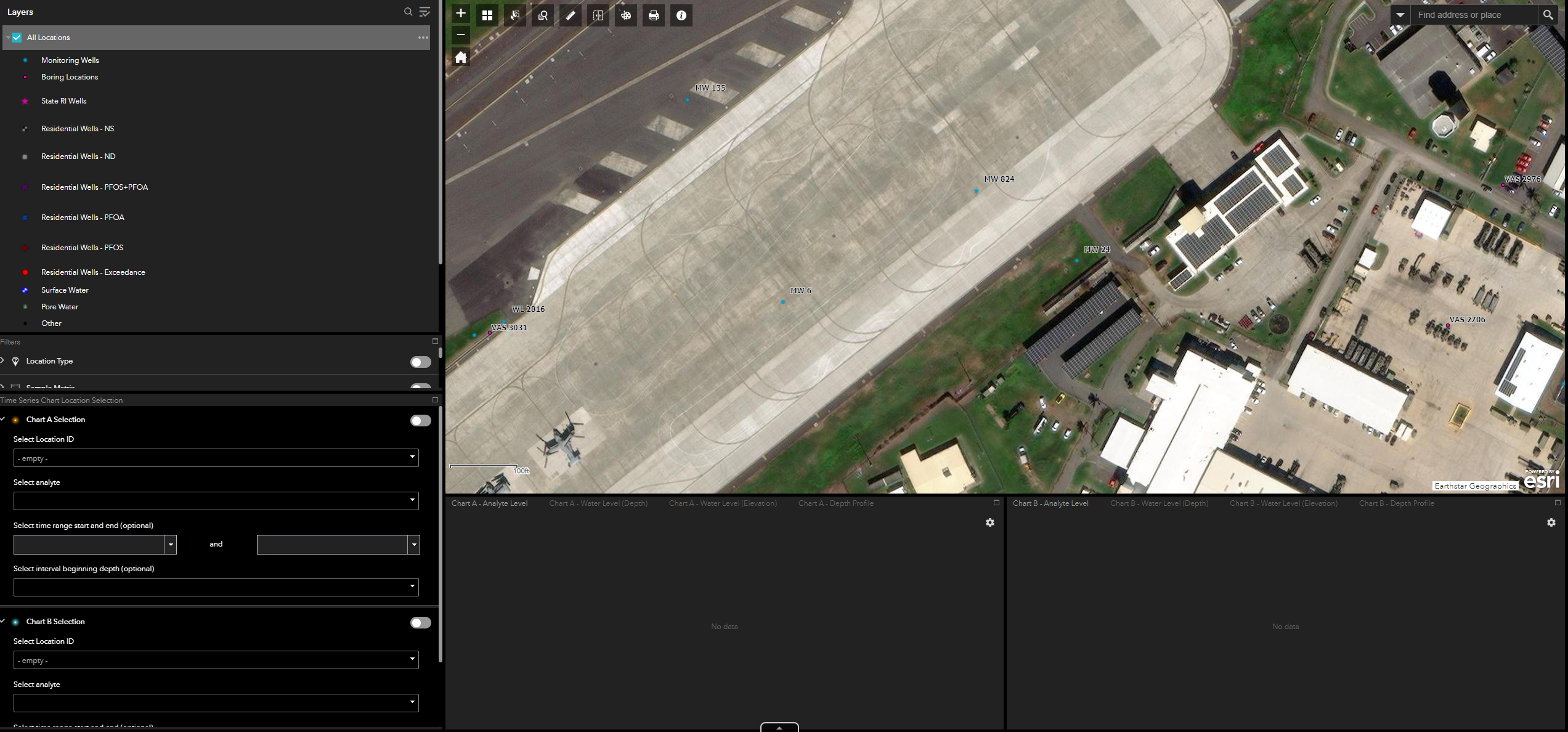

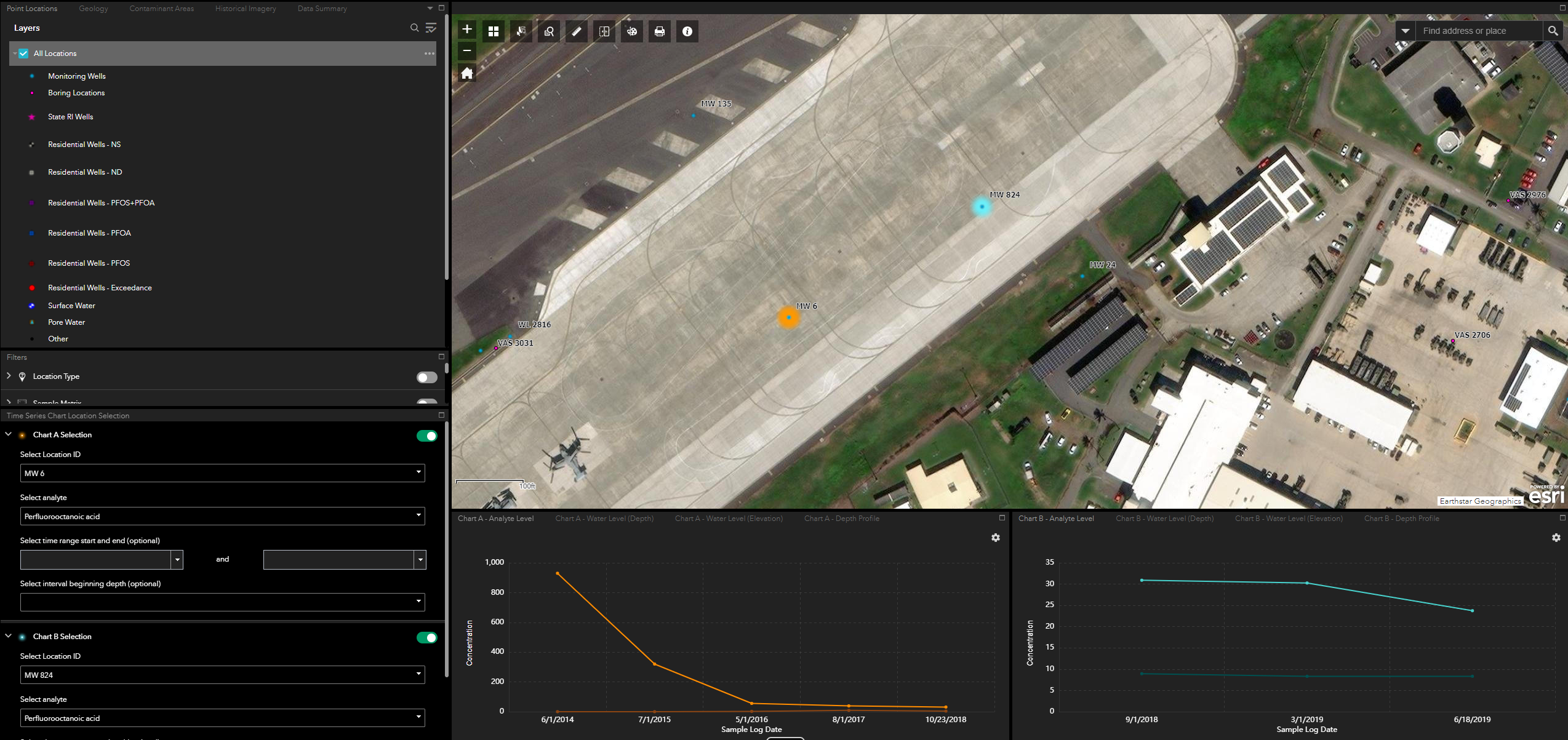

In my web map, I have visible by default in the map one copy of this layer with the default filter of "list_index = 0" to display the single parent point for each location, and I have multiple copies of this layer that I use to add a halo underneath/around the parent points and to populate the charts when the user selects a location ID. The copies of the layer have the default filter of "list_index = -1" to ensure that these points don't show up on the map and that the charts are empty until after a user specifies a location ID. Default view when loading the app:
View after selecting location IDs and other parameter for the copy layers:

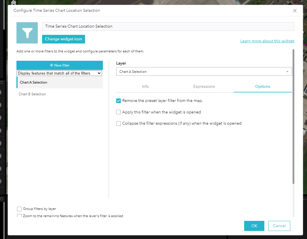

This is possible in Web AppBuilder because of the "Remove the preset layer filter from the map" option in the Filter widget:
I can not find a similar option in Experience Builder. I have tried removing the default filters from the web map itself and changing it to be a default filter within the dataset in Experience Builder, creating a separate Data view with the default filter applied, etc. but haven't had any luck getting this to work so far.
