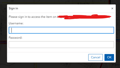

I'm recreating a Web AppBuilder application in Experience Builder on Arcgis Online, and it is missing the functionality to log in with organization credentials. If the map contains any data hosted on our local portal environment, it only gives me this generic popup, which can be closed to access the rest of the map.
In Web AppBuilder the popup will direct me to the correct organizational login page.

We do get a popup with just an ok or cancel in it as our connects to SAML.  We click ok and get in.  BUT we have all kinds of issues in the ExB after that.  For example if we use imbed widget with a portal source in it the browser goes into an infinite loop of logins and it grinds to a halt and never does display.  Looking at dev tools it seems to be trying to send the AGOL creds to Portal (vs the portal creds).  So it is not keeping them straight it seems.  We did open a bug now on this but I do not have the number.
