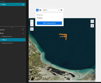

Hi, It is strange as I tried creating an experience builder app with only a map with a raster basemap (World Imagery) and no vector layers (to test the snapping theory).   The issue still occurs.  (this is even before deploying the app and just in 'Live' view in Experience Builder.  It does seem to be trying to snap to right angles or other lines created while measuring though.  I wonder if there is a toggle to turn this off to test if that is the issue.  Also I wonder if it is a 1.17 Exp Dev version issue but I imagine more people would have reported it if that was the case.
GISNCC_1-1755765345867.pngSee Right Angle 'helper' that appears when the measurement is close to a right angle.
