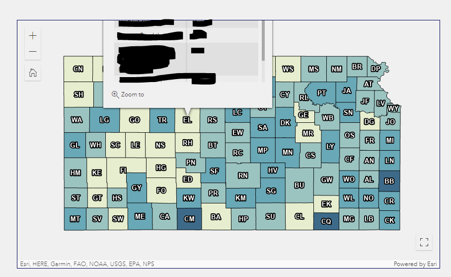

I have an ongoing issue with pop-ups running off the edge of maps when the map is embedded in a website . In this particular case, it is a web map (Classic) embedded in an Experience Builder scrolling page. When you click on some locations, the pop-up is cut off by the edge of the map. Here is a screen shot (the data is not approved for public consumption, so I had to black it out).
Screenshot of pop-up running off the edge of an embedded map.Screenshot of pop-up running off the edge of an embedded map.

After speaking to tech support, I've learned that this is a known bug. There isn't a great workaround, but I found that by changing from a pop-up with a list of fields (which creates a table) to a custom pop-up with just text, the issue is much less pronounced. I'm not 100% sure that it's fixed, but testing yesterday yielded good results. I just ended up doing something like this in the custom config:
Field One: {field1}
Field Two: {field2}
Field Three: {field3}
The downside is that fields with long names tend to wrap onto another line and the value gets a bit lost in the visual field, but it's better than cutting off half of the pop-up!
