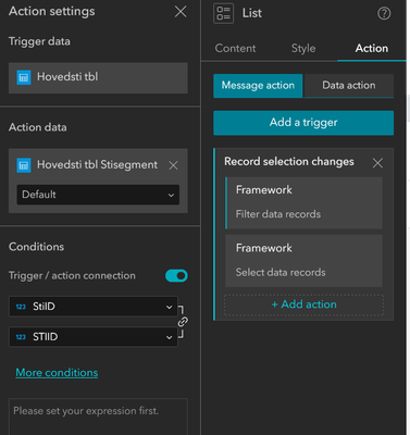

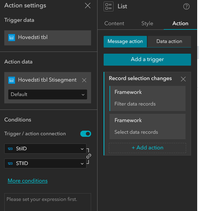

I have added theese actions to listwidget1:
  1. Record selection changes ->Framework -Filter data records> Triggerdata Maintracktable, Actiondata Relationtable, Action-connection maintrackID.
  2. Record selection changes ->Framework -Select data records> Triggerdata Maintracktable, Actiondata Relationtable, Action-connection maintrackID.
This put up a one-to many-connection between the maintrack-table and the relation-table.

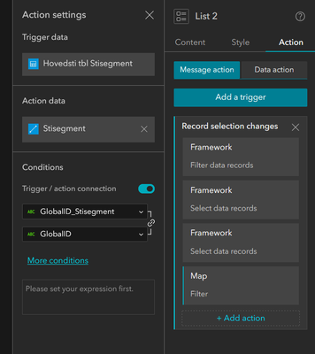

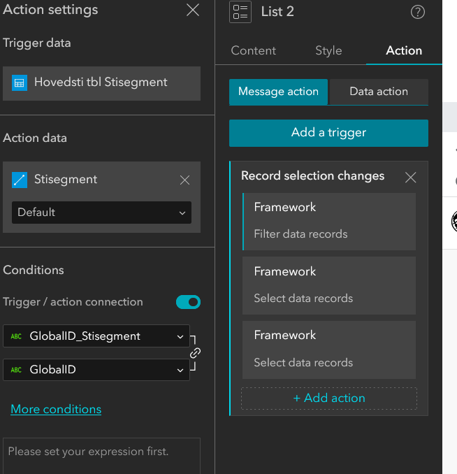

Then I have added List-widget2 with the relation-table. For this table, I have added joins(Actions) both ways, to the map-features and to the maintracktable.
This widget has a many to one relationship to the line feature service (the tracks). I.e. one track segment can relate to many rows in the relationship-table.
My theory is / what I want to do is:
When I select a row in List1 (Main tracks), I filter and select all common rows in the relationtable. This relation-table has action to filter and select track segments in the line feature service in the map. The result should be filtered and selected track segments in the map.
But!
This does not happen. It will happen if I interact with list2 with the mouse. If I click ONE time in list2, the filter and select in the map is activated. EB does not recognize the filter and selection before I have physically clicked in the list. Although the list is already filtered and selected through the action in list1.

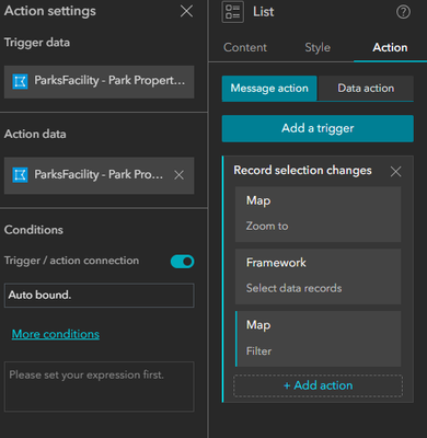

I tried to add a Map > Filter Action to the Relationship table. I had to configure it like this:
Still behave the same way - no action. Thanks anyway for the reply.

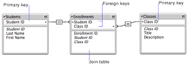

I found a picture that show my schema:
Source: https://help.claris.com/archive/help/17/fmp/en/index.html#page/FMP_Help/many-to-many-relationships.h...
You could replace the student table with my "Main tracks"-table, the Enrollments with my relationship-table and the "classes" with my track segment feature class.
So I cant see it it possible to put an Action from the left tabel to the right one. I have to go through the connectiontable, the relationshiptable.
