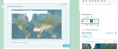

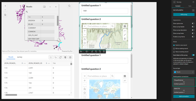

To record the geometry in your survey feature layer, you need to set the connection from `StarMap_Street` polyline to Survey's polyline geometry.
To achieve this, you may need to create a new survey and add a map question with the line type, then add the polyline geometry connection in the Experience Builder.
As you mentioned, your survey feature layer has the point geometry type, and I think maybe you don't set the geometry connection between the web app and the survey widget. Therefore, the default value geopoint 0.0 is added for all the records you submitted to the survey feature layer.
