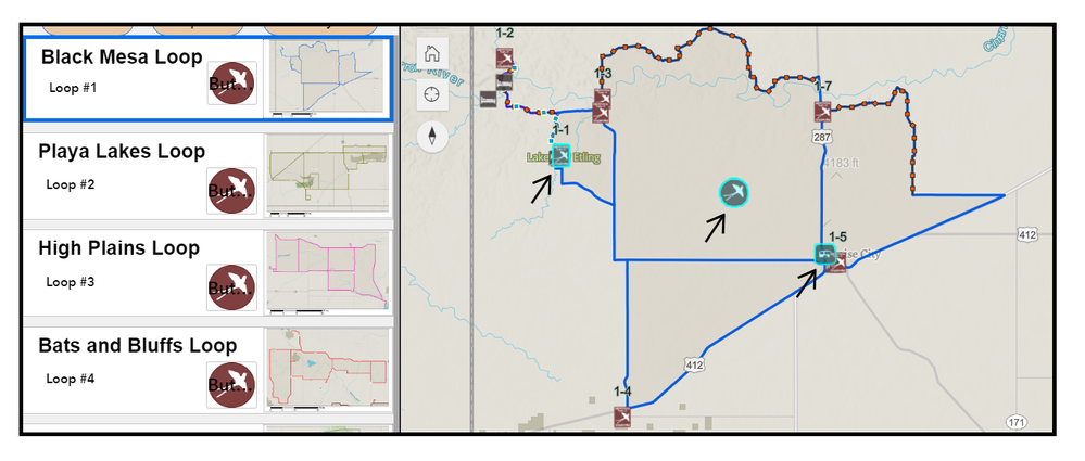

I am using a List widget and Feature Info widget that are looking at Point features in a Map widget.  Whenever I run my Experience, the first item in the List widget is always selected.  Is there any way to Turn This Off?
I actually have 3 Views, each with 1 List widget.  All three have highlighted their first item by default.  This is unhelpful in relation to the whole user interface that is the Experience.  See Image:
First Item of visible List widget is Center Point; Two other List widgets' First Items also highlighted by default.First Item of visible List widget is Center Point; Two other List widgets' First Items also highlighted by default.
