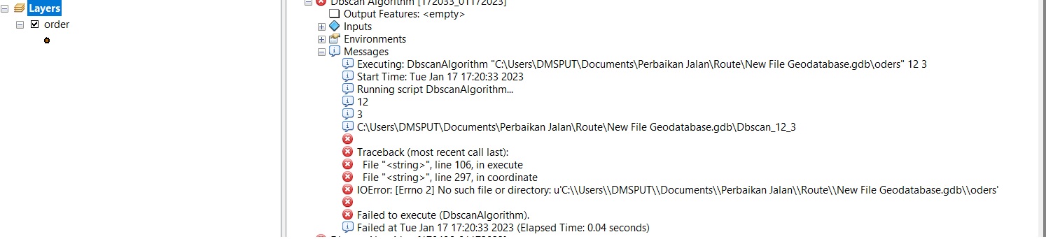

Hi Friends
i have been trying to create a cluster point with the DBSCAN method based on a python script I found on Github. I've tried changing the data type of the feature input parameter (from "DEfile" to "DEFeatureClass"), but it always fails when executed.
Here is the script and the error:

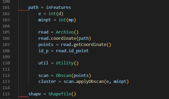

        e = int(d)
        minpt = int(mp)
        read = Archivo()
        read.coordinate(path)
        points = read.getCoordinate()
        id_p = read.id_point
        util = Utility()
        scan = Dbscan(points)
        cluster = scan.applyDbscan(e, minpt)

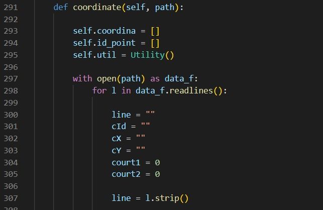

    def coordinate(self, path):
        self.coordina = []
        self.id_point = []
        self.util = Utility()
        with open(path) as data_f:
            for l in data_f.readlines():
