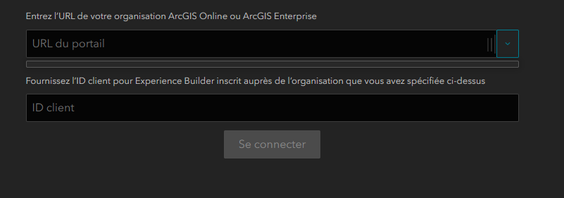

1. Start Experience Builder with a custom path: npm start -- --path /exb
2. Access the builder at: https://localhost:3001/exb/
3. User is redirected to: https://localhost:3001/exb/page/set-portalurl
4. The page attempts to fetch data from https://localhost:3001/signininfo (missing the /exb prefix)
5. The request fails with a 404 error
Expected Behavior
The Ajax request should be made to `https://localhost:3001/exb/signininfo`, respecting the subfolder path.
Actual Behavior
The Ajax request is made to https://localhost:3001/signininfo, ignoring the subfolder path.
