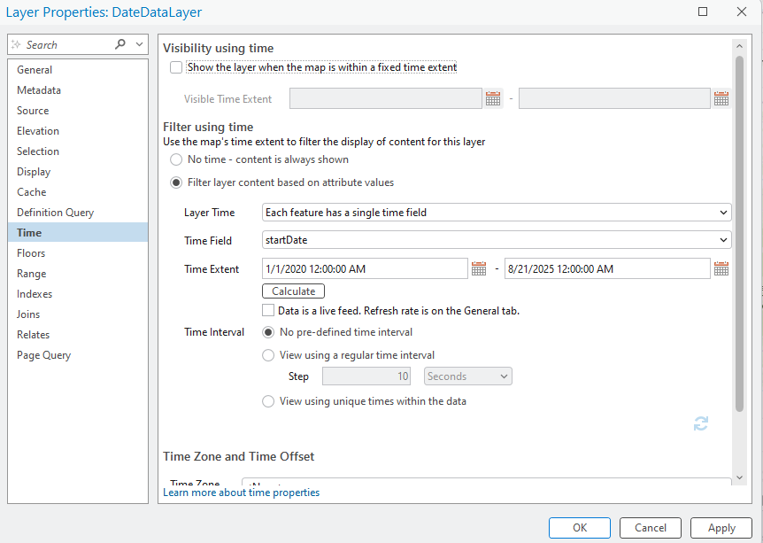

Thanks for the information. This workflow rarely occurred in our previous user feedback. I did some testing, and it seems like you can only generate something on the fly inside the Map Viewer, based on style customizations - but not saved to the map, which is ready for other applications to use.
Here is when you publish a time-aware layer, using ArcGIS Pro, what the configuration and the layer property look like - notice that it successfully contains a valid time info
See that when I tried checking the layer property outside MV from your data, there is no time info to be found:
Thus, what I suspect is that -
Through this particular doc workflow, you might be able to create a new feature collection, time-aware, inside MV, which can only be used inside the Map Viewer. It does not update the layer property, and that's why ExB cannot obtain any time info to be used for the Timeline widget.
You might want to publish the layer/map from Pro using the previous configurations, if possible.
