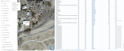

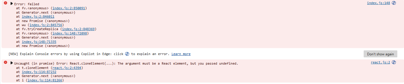

I am using the out of the box map layers widget in EB DE 1.18 that was released today, and I am unable to export to shapefile, file gdb, or KML from the map layers widget. Has anyone else had luck trying this? I don't get many error messages, but when I choose one of the 3 export options I get the console error below. Prior options such as CSV, JSON, and GeoJSON export as normal.

I haven’t tried the 1.18 release myself yet, but that error definitely looks like a React rendering issue — specifically with how those export formats (Shapefile, FileGDB, KML) are being handled inside the widget.
The fact that CSV, JSON, and GeoJSON still work suggests the widget’s core logic is fine, but something's missing or misconfigured for the other formats — maybe a handler wasn't properly registered or there’s a broken condition in the export component.
I’ll try to spin up a test on my end soon, but it wouldn’t surprise me if this is a regression in 1.18. You might want to raise it with Esri or check GitHub to see if others have reported it yet.

@VenkataKondepati I did a little more testing and a few things of note. The issue is occurring in the Table widget as well.
It oddly works in the Select Features widget and map pop-up, but requires an Enterprise or AGOL login. There is a community post about this.
https://community.esri.com/t5/arcgis-experience-builder-ideas/export-shapefile-from-exb-pop-up-windo...
The query widget prompts the dialogue box, but gives an Error 99999.

Currently, "Export Records" uses a different method from "Export All Data". Exporting records to SHP/FGDB/KML formats requires the user to be signed in, though we are considering improvements to this feature in future releases.
"Export All" usually uses the ArcGIS REST API's createReplica operation. The error message you received suggests that there might be a bug with the createReplica request.
Could you please check the Network tab in your browser's developer tools and confirm whether a createReplica request is being made when you try to export? If so, what's the status of that request?
