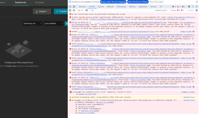

When click the "login" button, no response.
The browser console is as  attached.

I see CORS(Cross-Origin Resource Sharing) errors in the snapshot, which tell that https://localhost:3001 can't fetch the portal URL's resources.
Maybe the portal admin has forbidden CORS requests?
See:  https://enterprise.arcgis.com/en/portal/latest/administer/windows/restrict-cross-domain-requests-to-...

I have used the same Open SSL  certificate to Exb, IIS(for js SDK and calcite), portal.
It seems the issue is from offline calcite components configuration steps.
I deploy local "calcite" follow this:offline calcite configuration
