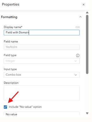

When you configure the form in Map Viewer, you'll see the option to remove 'No Value' from the list of choices for that field. That could be a workaround for the time being.

Hi, thank you for your response! Where can I find these properties in the Edit Widget in Experience Builder?
Edit: never mind, found it!
