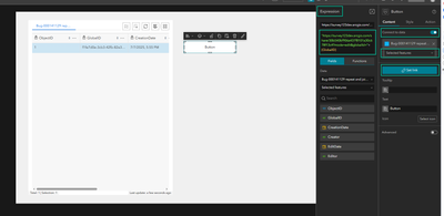

Hi @SkiSantaFeAdmin ,
Thanks for sharing! I have created a sample app with the "Edit" button you described. Could you please check if you appended the {GlobalID} variable to the URL as shown in the screenshot below?

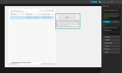

If you set the expression correctly, but still get the error. Could you please let me know what the URL looks like when a connected feature is selected?

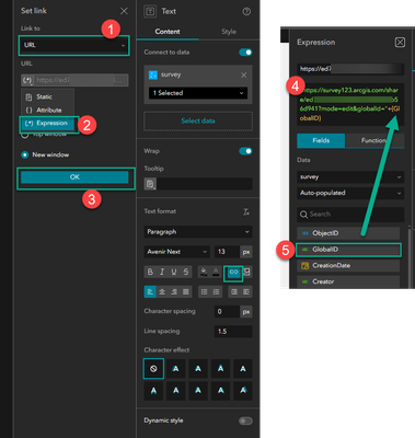

Sorry for the late response. I tried to create the list with the edit linked button like yours. I think you still need to set the link using the Expression as shown in the screenshot below. I guess the reason you got the error on the web app is that the ${GlobalID} in your syntax does not pass the real GlobalID to the linked button.
