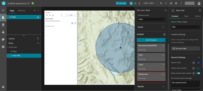

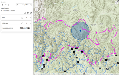

I have another question, are you showing the summary in Near Me widget? Near Me should not show the layer if there is no intersecting features. For example in this app, I have summary configured in Near Me widget for Wilderness layer, when it intersects with the layer, it shows the summary (Screenshot 1), if the search area does not intersect, the layer name does not show up (Screenshot 2)

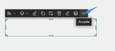

If you are using Text widget to show your summary you can use arcade expression as Ke suggested, Arcade support will be available in Text widget later tonight after ArcGIS Online June update.

I think the Arcade script can be used to solve this. Arcade will be available in ArcGIS Online tomorrow.

Yes, you can do that using arcade expression as well
