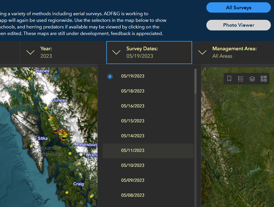

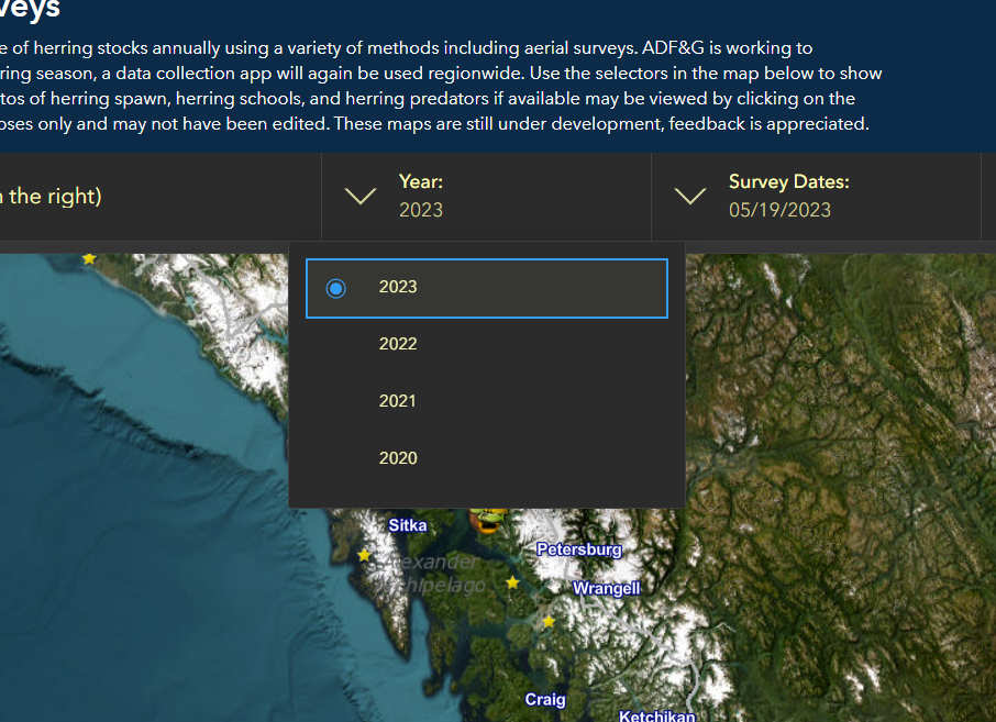

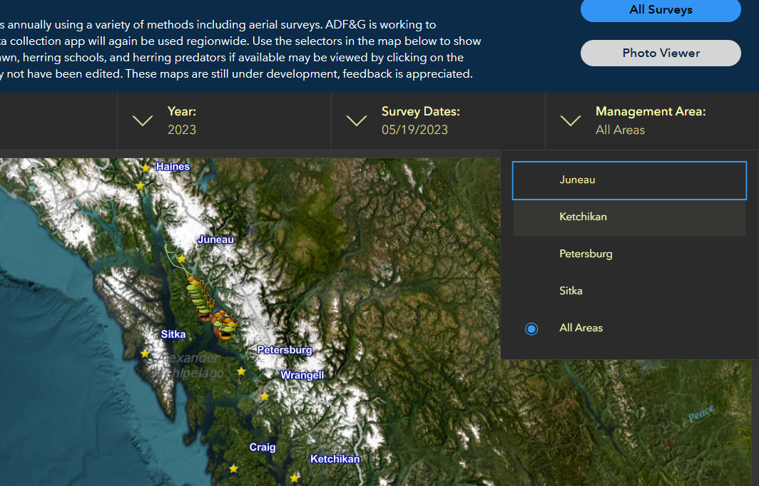

Are the drop-down widgets in the images below stock in Experience Builder, or are these custom? Here is a link to the experience to see it yourself.
https://experience.arcgis.com/experience/52ffb83c47844ef5ba14e7a0f063fcc7/page/All-Surveys/
I have a project where I would like to do something similar and show data by the year, week, and mgmt area/city, and I have been at it for hours trying to figure out those drop-downs. I will create layers that can be turned on and off, but I would like to do it this way for aesthetics and ease of use. Any suggestions/answers would be much appreciated!
JenniferAcunto
That looks like an ArcGIS Dashboard embedded inside of an Experience Builder app. Those dropdowns are category selectors in the dashboard header.
- Jen

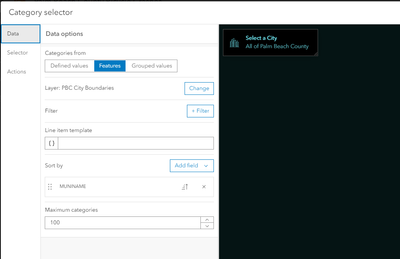

I had to go look, it's called a category selector:
You can adjust the settings and what happens when a category is selected (e.g. filter, zoom, etc).
