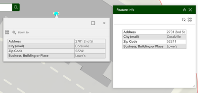

I am setting up a Developer 1.18 app right now and don't see that anything has changed.  At least I can't seem to find a way to configure everything the way I want.  Like some of the others in here, I just want the ability to click a feature and have its configured popups display in Feature Info only.  I don't want what you see on the left to show up at all, for any of my layers.

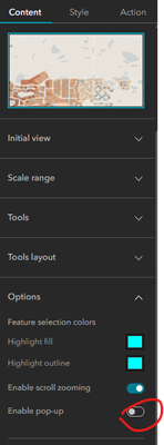

Then you want to go into your map widget, scroll down to Options, and then toggle off the Enable Pop-up option:
That doesn't kill the popup from the web map, meaning Feature Info will still work, but the ExB will not show the popup.

Here is something that got me closer to what I want.  I at least get the Feature Info widget to open when I click the desired feature (with configured popup).
In the Map widget add a Trigger.  Select Record selection changes.  Under widgets, select Widget Controller (mine are in a widget controller).  Then select 'Open widget'.
Now when I click my feature the Feature Info opens automatically and the configured popup is displayed.
The downside?  The popup within the map still shows up.  If I disable Map > Options > Enable pop-up then neither work.
