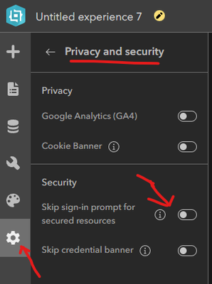

JeffreyThompson2
MVP Frequent Contributor
https://doc.arcgis.com/en/experience-builder/latest/build-apps/general-settings.htm
There is an option as of the latest ArcGIS Online update. Go to the Gear. Then Privacy and Security.
