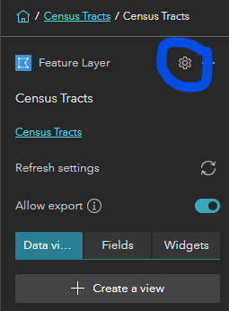

For a given layer in a data source, here's where you can filter the features:
(Note that once you filter the features "globally" like this for the layer, the data views you can create for the layer (if you need them) are also filtered.)
