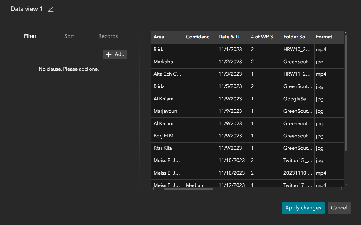

Hello,
So i have a Web experience project with a feature layer containing incidents with their date & time, coordinates and other info. (Below is the table)

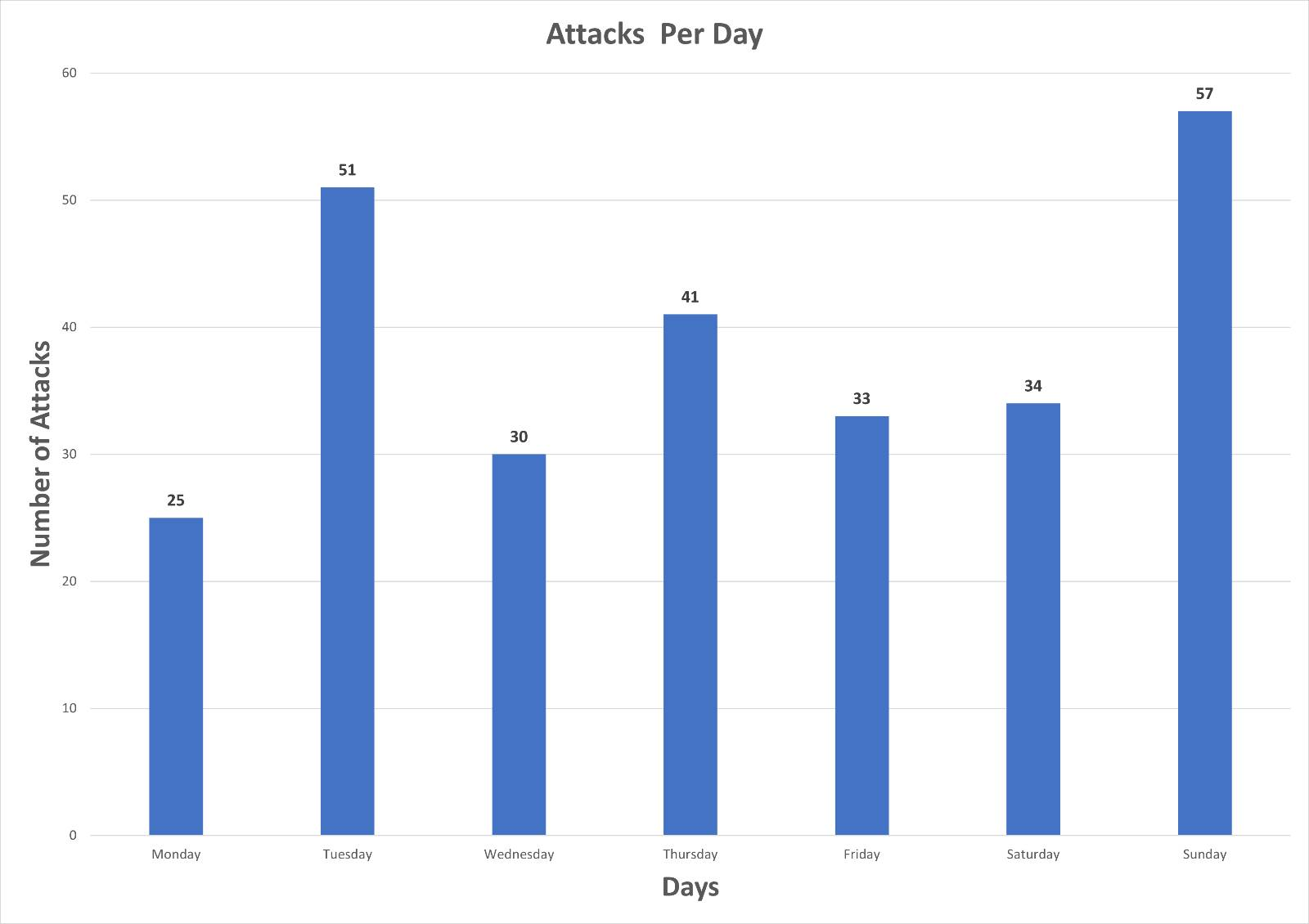

I want to create a chart that show the number of attacks on a daily basis. (Below is an example of the chart)
The trick is that i want this chart to also be linked with the main timeline slider that controls the map and other charts and information.
Is this possible in Web Experience? If yes, i would greatly appreciate your guys help.

Wei_Ying
@AhmadBaydoun @JasonBOCQUET
Currently the bar/ column does not support a date field parsing. It only treats the field as a string, so cannot group incidents for specific time binning.
The good news is this feature is coming! It will be available in November AGOL release.
