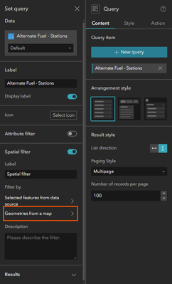

@GeoFUNKE, I think you can achieve this with the query widget. In the query widget configuration, if you scroll past the attribute filter options, you'll see the spatial filter options. Choose "geometries from a map," then "drawn graphic."
Here's an example where I have a query widget configured this way (with "polygon" being the only option I want to give the user).
From the user side, they draw the polygon on the map, click "apply," and then the query results pane comes up. This shows the number of features in the polygon. From there, you can view their pop-ups or whatever fields you designate. If you leave the data action option on, you can export the results.
