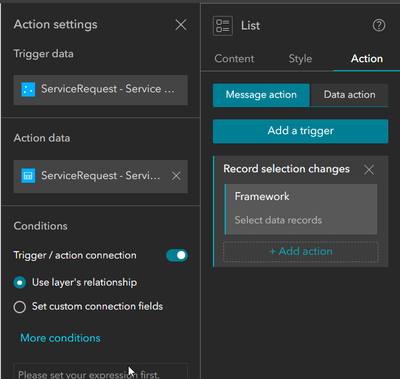

I think you can try setup a message action from List widget like this:
use the "Record selection changes" - "Framework" - "Select data records".
Use the Address layer (used in List) as Trigger data, and use your result data (used in Feature Info) as Action data. If the data has relationship already, they are auto-connected. Otherwise use the Unique ID as the connect field to connect them.

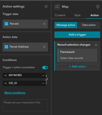

Thank you @Wei_Ying , I tried your suggestion, but it's still not working as I would like.  I feel like I'm missing something really simple.  Here is how I have my Map set up:
Selecting a parcel on the map filters my list and feature info widget:

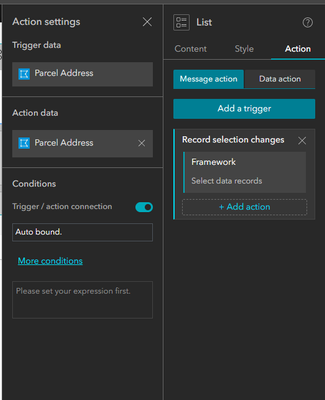

I set up the record selection trigger on the list:

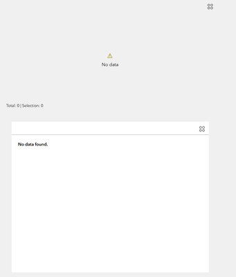

When I click a record on the list, I get no data found for both the list and feature info:
