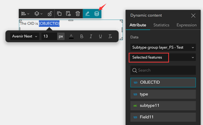

Hi @Ed_,
It could be done in Experience Builder.
You could add an expression in Text widget like this.
Thanks,
Ke

Hi @Ed_,
Thanks,
Ke

@Ke_Xu thank you for your response 🙂 so if i choose "Selected features" in the text box on page 2, these in my case will then be coming from the selected features in the table on page 1 right?

by Esri Regular Contributor
Right. Select features in the table on page1 and then get the result in the text widget on page 2.
