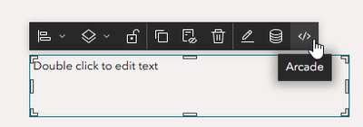

Alternatively, you can use a text widget with Arcade. With Arcade, you can write a single script that calculates and returns these values.
