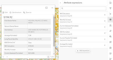

Attribute Expressions in Map Viewer are incredibly powerful and extremely useful. Unfortunately, bringing those wonderfully calculated and formatted attribute expressions into widgets in Experience Builder currently doesn't seem possible.
Your only options for "Connecting to data" are the raw attributes from layers in your web map. The only place within Experience Builder that your attribute expressions appear is in the map pop-up and Feature Info widget.
Map Viewer Attribute Expressions should appear in the "connect to data" list for ALL EXB widgets.
EXAMPLE:
I created an attribute expression called "Mill Calculation" in my web map in Map Viewer and want to connect the text widget in EXB to it.
^ "Mill Calculation" Attribute Expression in Map Viewer ^
Unfortunately, in the "connect to data" list for the text widget, none of my glorious Attribute Expressions are available.

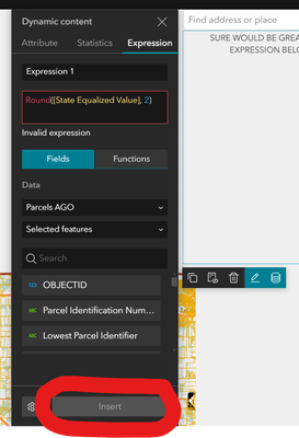

A possible work-around for this is to re-create the attribute expression in the Dynamic Content, Expression tab. I tried this and unfortunately, Arcade expressions are not supported here, but I guess that's a whole different idea...

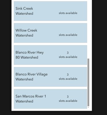

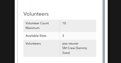

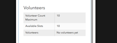

Yes!!!! This drives me crazy every time ... currently struggling with null values in my source data (because of a hosted join layer with statistics) and presenting them nicely in an experience builder, but I can't seem to fix it with an 'expression' in dynamic content and the attribute expressions built in the web map aren't available to use when configuring the Text widget.
here's an example -- we need to present the number of available volunteer slots (calculated through a hosted layer join) -- if there are no volunteers, then the summary statistic is null -- which means there's lots of slots available, but the calculation doesn't work because of the null...
attribute expression works great!  but not available in the app...
Would love to see this implemented!  Configure once ... use everywhere!

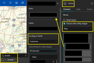

In ArcGIS Online, it is now possible to add arcade expressions to a layer directly in ArcGIS Experience Builder and to use them in the table widget. There is also a function to copy the arcade of a map expression set in the web map into the arcade script window in Experience Builder. However, if the map expression is updated in the web map, the builder must also update the arcade expression manually in the Experience Builder - they are not linked.

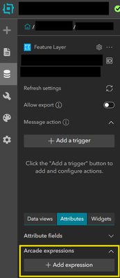

Step 1: Add an Arcade Expression to a Layer in the Data Tab of an Experience Builder
add-an-arcade-expression-in-the data-tab-of-esri-arcgis-experience-builder.pngThe Add Expression button is located under the Arcade Expressions section title of a selected layer in the Data tab of Experience Builder in edit mode.

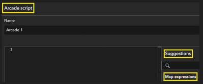

Step 2: Copy a Map Expression From a Web Map Into the Arcade Script for the Arcade Expression
copy-a-map-expression-from-a-web-map-into-arcade-script-for-feature-layer-in-data-tab-of-esri-arcgis-experience-builder.pngMap expressions are found under the Map expressions section title under the Suggestions section title within the Arcade script window in Experience Builder in edit mode.
Step 3: Add the Newly Added Arcade Expression to the Table Widget
